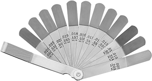

Did a go-nogo check on all the exhaust valves and they all easily passed a 0.18mm (0.10 + 0.08) feeler gauge and wouldn't pass a 0.25 mm gauge. All good and nothing is even close - not even bothering to check these more closely. (Never had to adjust an exhaust valve in 185,000 miles on my '07.)
Went to the intake valves with the 0.15 mm (minimum) gauge. Left-to-right everything passed (some were fairly snug) until I got to the last one (4-2). 0.15 wouldn't go and even 0.13 wouldn't (0.10 went easily). Figure this one is right around 0.11 or 0.12 but can't choose anything between 0.10 and 0.13 with the gauge set I have. Last one I checked and it is off enough that I won't ignore it. I guess since I am going there, I might as well make careful measurements of all the intake clearances. Since I have to open it up anyway, I might as well target the 0.20mm 70 percentile for all of them and probably never have to touch it again.
I will pull the intake cam tomorrow and see what shims are in there and see what I need. Hope the local dealer (Yamaha or Honda) have the ones I need or I'll be picking up some carbide paper and making my own custom shims!
This is the second Gen II that I have done valve checks on and I have issues with that particular valve (4-2) more often than any other. Anyone else have the same experience with this or know any reason this should happen? I think I had three valve checks on that bike where I had to make some minor adjustments. Until the last time, I only adjusted the ones that were out of spec - for that check, I did them all.
Metric gauge set I have has 0.06, 0.07, 0.08, 0.10, 0.15, 0.20, 0.25, 0.30mm (and larger). So, I can't do 0.09, 0.11, 0.12, 0.19 with any combination. (They should have included a 0.05mm but it would be pretty flimsy - would let you do all clearances in 0.01 mm increments.)

Slip a couple of Imperial feelers in there... .005 = .127, .006 = .152, .007 = .177. .008 = .203, .009 = .228

Would have been a lot easier if they had just included a 0.05mm in the metric set. Flimsy but always used with another gauge to fill in the missing numbers.

Better yet if the metric sets would have included 0.05 increments...... I haven't found one... but one can buy individual feelers if you want to pay some extra at a specialty place.

0.04 mm, 0.05 mm, 0.06 mm, 0.07 mm, 0.08 mm, 0.09 mm, 0.10 to 1.0 mm (0.05 mm increments) 3" 1/2" 3 3/8" 1/2" 2334A66 12.15
These are the specs, Part # and cost at mcmaster.com for the metric feeler gauges I use.

Lots of sets out there. The cheap set I have would have everything covered with the addition a 0.05 mm. I'll pick up another better quality set before the next time - these were good enough. The intakes all ended out in the 0.18 to 0.21 range so I probably won't even check for another 50,000 miles.
