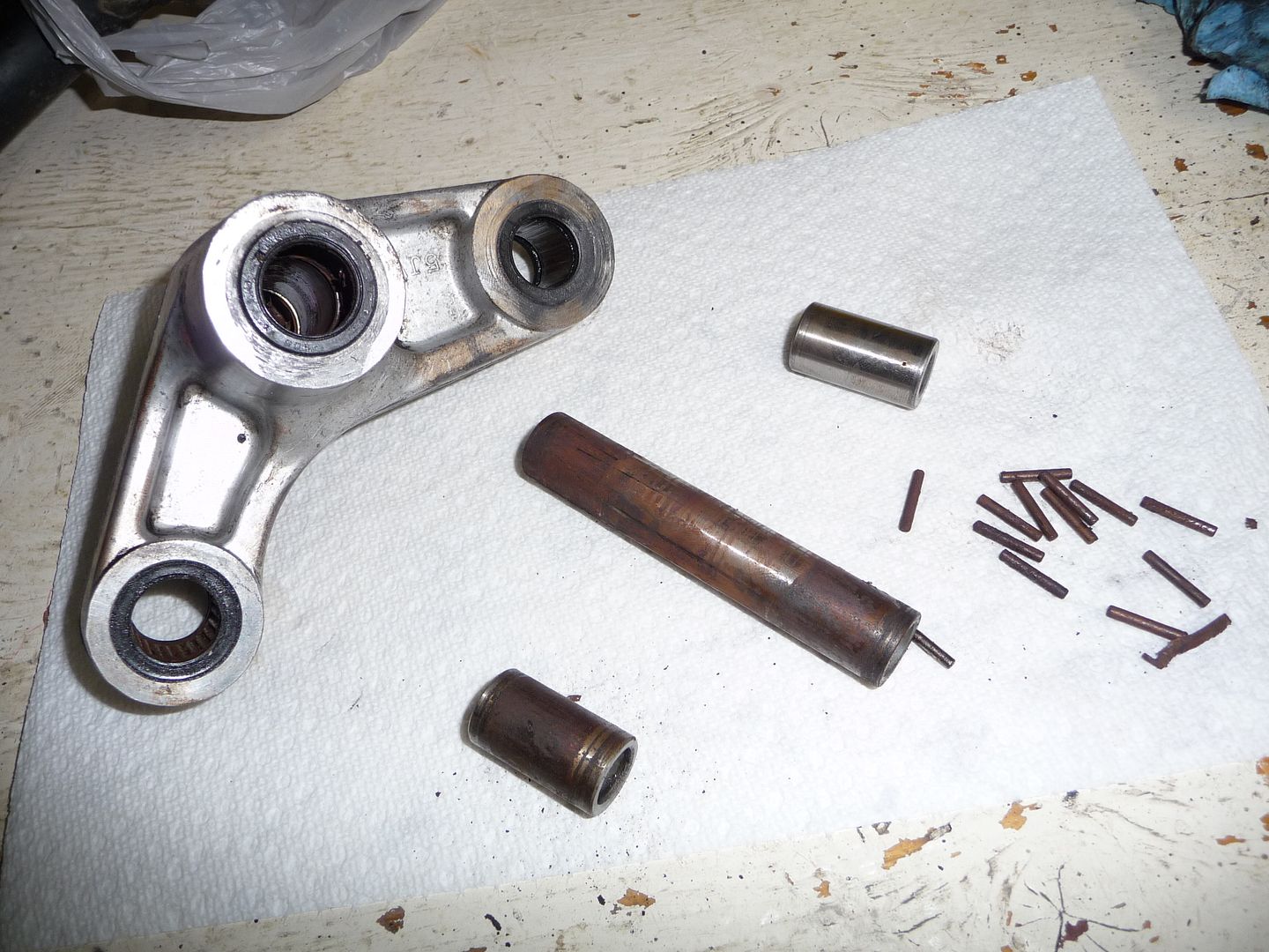

This is what I found after letting my '05 go too long without proper relay arm maintenance. Ignore at your own risk.
This is what drove me to develop the zerk fitting install mod.

There are grease seals on them thar bearings..... spraying from the outside ain't gonna do it I'm afraid. At the least, you can remove the links and lower shock mount, pivot the suspension arm down to lube all but the front frame mount. Takes all of 30 minutes.
