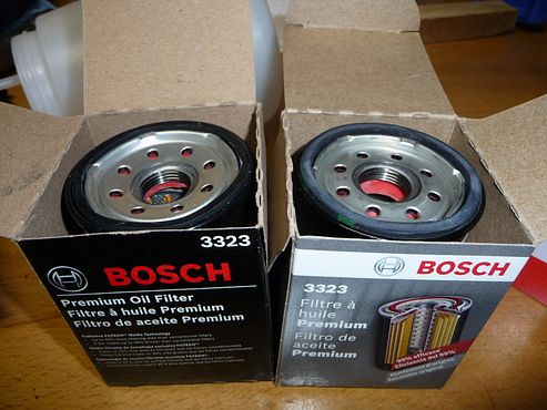

Here is a picture of both. The old design filter is on the left and the new design filter is on the right. Here you can see the concave design verses problematic new convex design.
wheatonFJR and Harald loved this

Yes, I have Norm Kerns modified union bolt as well. I just added the picture to help show the problem to those that might not understand the issue.wheatonFJR wrote: ↑Mon Nov 19, 2018 12:14 pmI use the 3323s...but some guy from Ohio sent me a machined oil bolt that makes concave/convex a non-issue these days.
Uncle Hud, rbentnail, and wheatonFJR loved this
