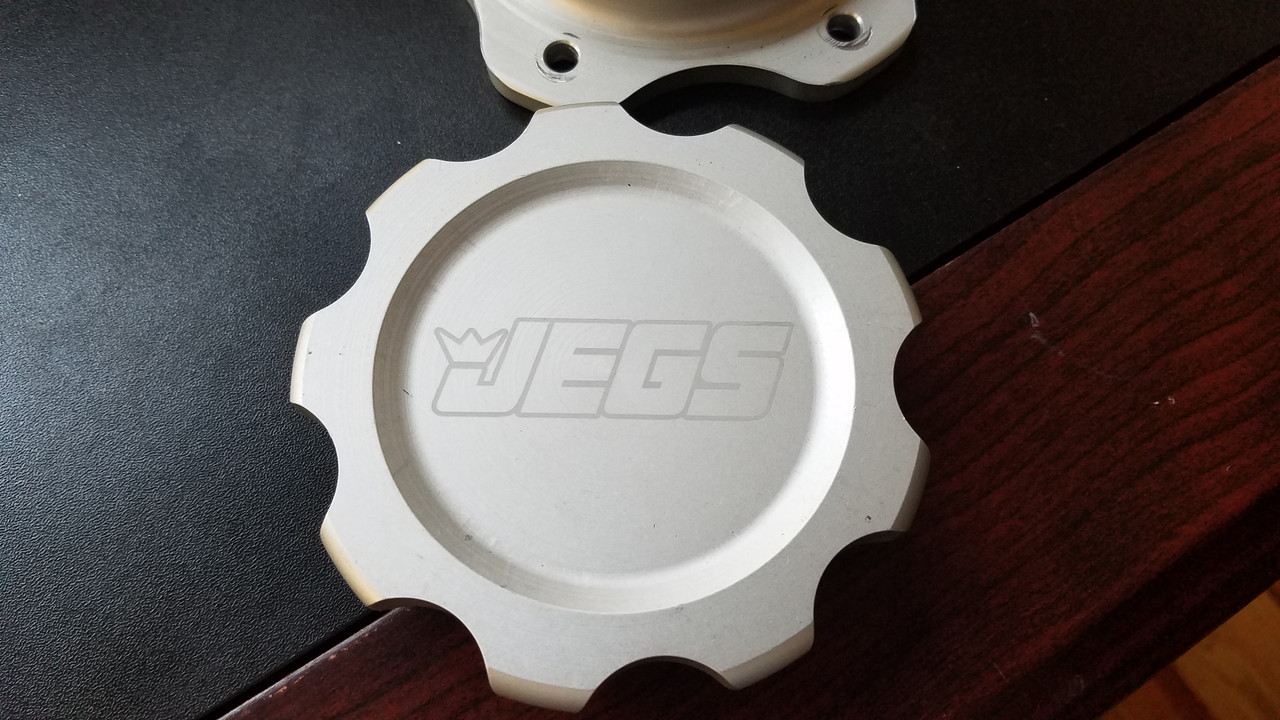

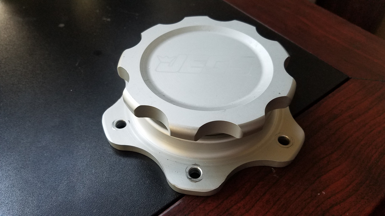

Joe asked me to post up some pics of the filler cap I would have used on the tank I bought from Joe last year. I never installed the cap - sold it to the aux tank hoarder - dcarver
This is a JEGS screw on cap, non-vented. The holes in the flange ALLMOST lined up(would take a slight bit of filing to fit) with the holes that Joe had drilled for the other filler cap? (forgot the name)
