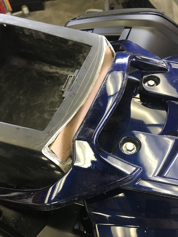

Going to revive this thread because I'm going to refit this smuggler to my new to me 2016. My 2013 had a Givi rack and the 16 has the stock rack. I'm going to have to modify the back of the box and lid to make it fit.
Heres the build pictures, maybe it will stick around - https://postimg.cc/gallery/0rzZcJn
The back of the box needs to be cut back, I did that yesterday but it's too cold to do much with it today.
Once I fill the back in and get it smoothed out I'll make the lid or modify the original one.

Uncle Hud wrote: Tue Jan 12, 2021 11:21 am Hey, kieefjr, would you be interested in making one from scratch, and if so, how much money would you need to make it happen? I'm willing to bet you'd have several requests from our buddies around here.
I might even be convinced to ride up yonder and pick it up ... routing through Newfound Gap, of course.
Thanks for vote of confidence but it would be cheaper to find one from Corbin. This is very time consuming and mine is definitely not as perfect as Corbins.
The first one I made for my 05 model year I designed and built during recovery of knee surgery, the current one I did in the winter.
It’s messy, time consuming and dusty work.
Did I mention time consuming?
It doesn’t help being meticulous and anal.
This little mod I’m doing has taken up two days already and I just finished, well hopefully finished the glass work on the box, haven’t started on the lid because that will be last.
I once this glass hardens I’ll grind and sand and might have to add more glass.
Then Bondo is applied and more harden time.
Sand and repeat the process maybe again or three times. Then filler putty sand and paint.
Still not sure how well bonded this mod will be, the seam might crack under vibration?
Then start on the lid.
So I don’t mean to be rude but no I’d rather not.

Glass work came out good and strong.
Set it in place on the bike and plenty of clearance and looks even with a correct gap between the the rack and box.
Sanding the rough edges a roughened up the surface for bondo.

Got the bondo and putty work done. Started on lid.

Getting pretty close.
Adding paint only enhances the defects so it’s putty, sand, paint, repeat.
I cut the back off the old lid instead of making a new one.

Completed
