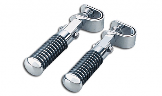

Thinking about putting some highway pegs on the Trex engine guards on my 14ES. Really couldn't find any good info while searching, so I am asking the collective. Who has put highway pegs on Trex engine guards and where did you get them. Thanks

There are a huge number of clamp-on foot pegs which could work on the T-Rex guards. The pic is a clickable link to foot peg clamps, you would then have to buy the foot peg for the clamp. They will be variations of this form:

Thanks Ionbeam. The problem is the Trex guards are 7/8 inch diameter and all the clamps I am seeing are only good for 1 inch diameter. Of course, I guess I could cobble up a shim - just figgered someone here would already have done this.

Go on to Amazon, search for RIVCO Anti-Vibration Highway Pegs, they are $49.95. Amazon sells a 7/8" bracket that matches the pegs as well search for BKRider 7/8 Clamp. I have had these on my FJR Canyon Cages for 50,000 miles. They have worked well for me on the FJR. I bought a set for my KLR for my trip to Inuvik NWT last year, the vibration of the ALCAN, Dempster and Cassiar highways caused a crack in one of the foot peg attaching brackets which are made of Aluminum. No problems on the FJR.

Hah - thanks John for the confirmation. I ordered these earlier this afternoon.bigjohnsd wrote: ↑Thu Jun 14, 2018 6:04 pm Go on to Amazon, search for RIVCO Anti-Vibration Highway Pegs, they are $49.95. Amazon sells a 7/8" bracket that matches the pegs as well search for BKRider 7/8 Clamp. I have had these on my FJR Canyon Cages for 50,000 miles. They have worked well for me on the FJR. I bought a set for my KLR for my trip to Inuvik NWT last year, the vibration of the ALCAN, Dempster and Cassiar highways caused a crack in one of the foot peg attaching brackets which are made of Aluminum. No problems on the FJR.
