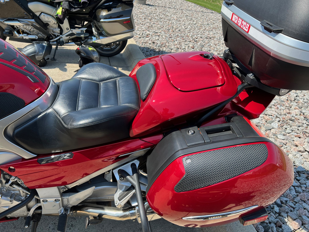

Givi SR357Madmudder wrote: ↑Thu May 23, 2024 11:58 amWhich rack and do you have any pics?RedRiderMN wrote: ↑Thu May 23, 2024 10:08 am I installed my Smuggler with a Givi rack, just had to add some washers to the rearmost bumpers on the Smuggler (as Corbin suggests). Seems like it was about 1/4" of spacers required. Good luck!
