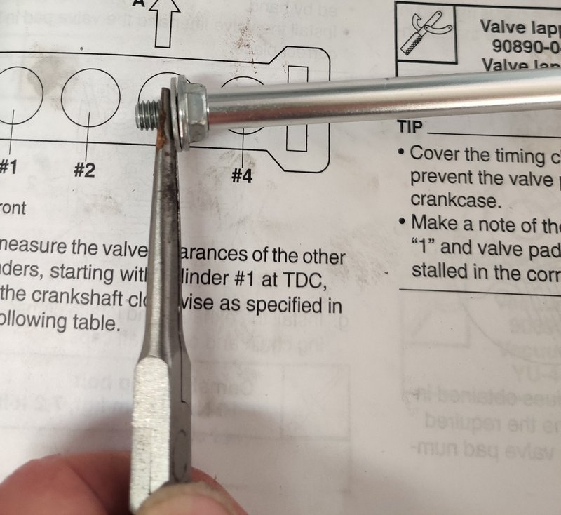

I am surprise nobody commented on the idea of using a thin telescoping magnet to install the CCT plug. This will arrive on my doorstep today. I am eager to give it a go. If the magnet doesn't work I will cut a slot on the plug.

I didn't find the CCT plug all that difficult to install. The CCT bolts are much worse and the slot really helps for these.
I have a telescoping inspection mirror that has a magnet on the other end.

Today I removed the camshaft and installed one shim to increase the tolerance from .006 to .0075 (loose 7 tight 8). Reinstalled everything. The valve cover is a PITA. No clearance at all. The gasket dog ears drag across the chain. The gasket came loose above the chain but I the valve cover installed and used and inspection mirror to assure the gasket was properly in place.
This worked like a champ putting the CCT plug bolt in place. A needle nose pliers and a thin pencil magnet. The magnet fit perfectly in the recessed part of the bolt head. One try and in it went.
