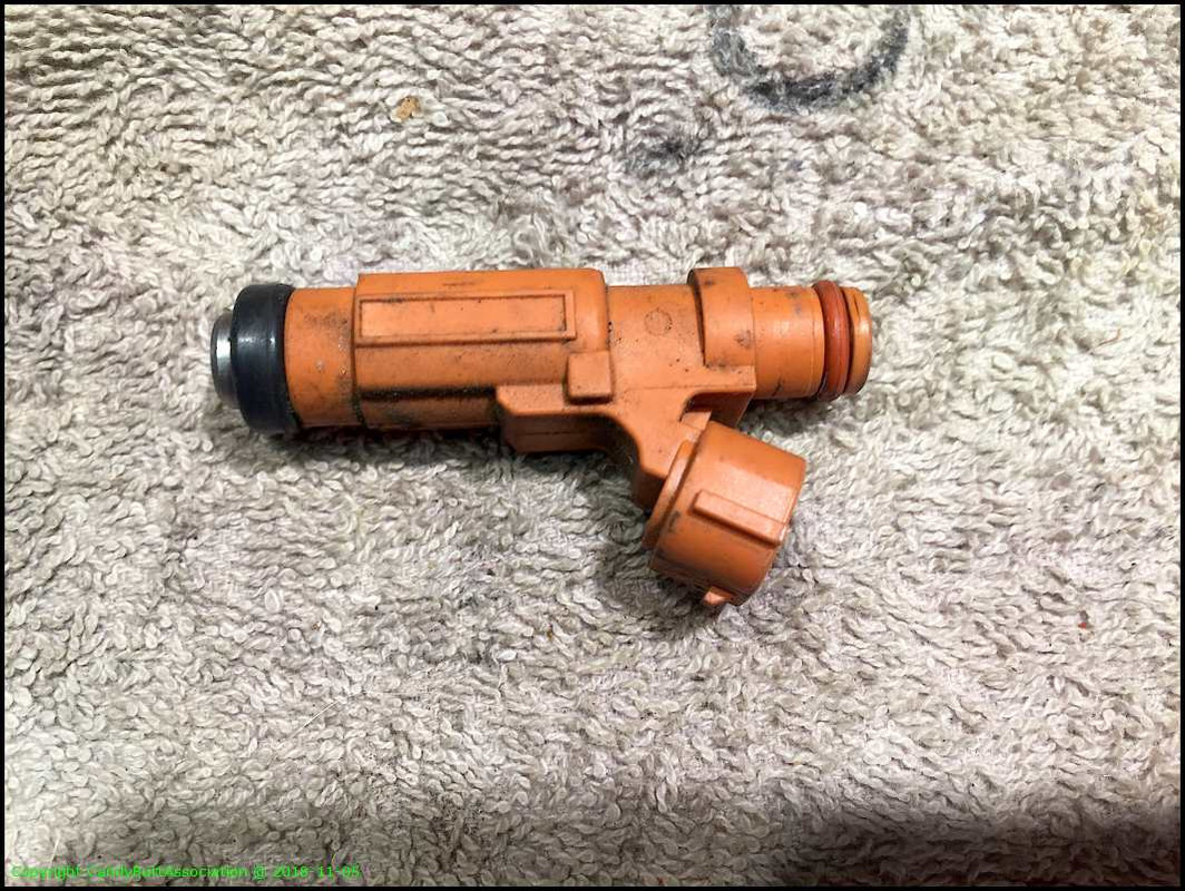

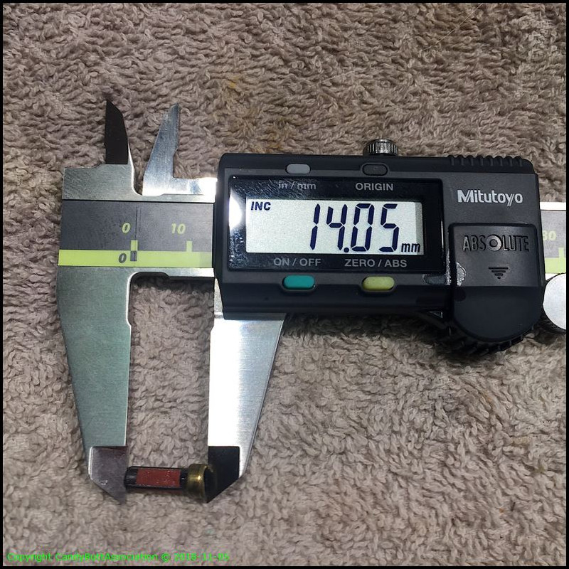

Got any photos or diagrams of the injector inlet filters? I'm thinking the next step is to pull off the throttle bodies and do an extensive cleaning, and check those injector filters at the same time. Check the fuel rail pressure as well. Has to be fuel related, I think. Just not that many things left to change or check.

Festus wrote: Fri Apr 29, 2022 6:39 pm Got any photos or diagrams of the injector inlet filters? I'm thinking the next step is to pull off the throttle bodies and do an extensive cleaning, and check those injector filters at the same time. Check the fuel rail pressure as well. Has to be fuel related, I think. Just not that many things left to change or check.
New pump came with a new filter, yes.
Photos courtesy of dcarver.
Inlet filter "baskets" are part of the injector. They might be able to be cleaned by a dip in an ultrasonic tank without taking them out of the injector. Generally can't be removed without ruining them. If you pull the injectors to look at the filters, you might as well get the injectors refurbished. Not terribly expensive and they will be cleaned, filters replaced, flow checked and spray pattern verified.
Edit: If it runs right with the other tank then it ISN'T the fuel injectors...
